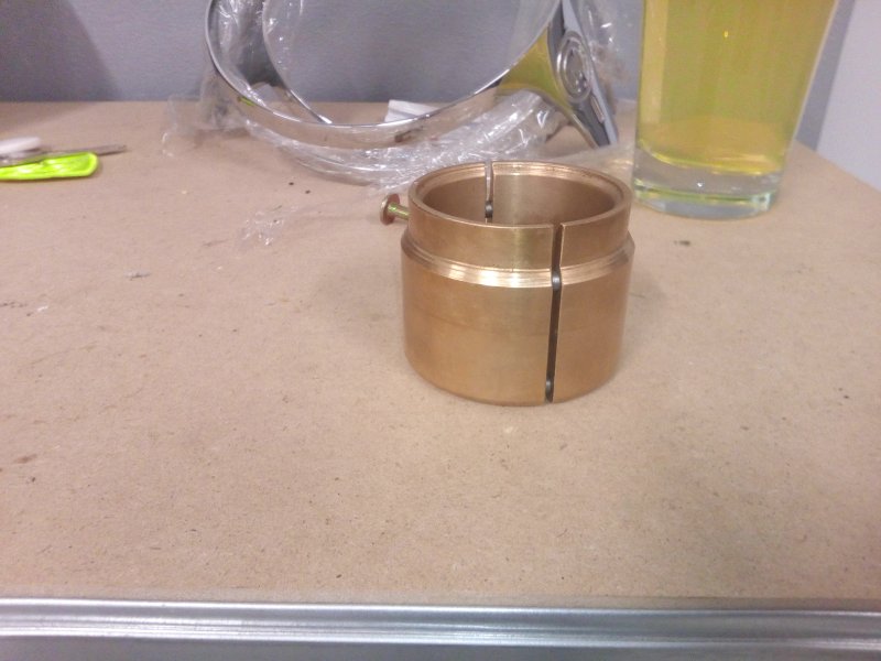

http://www.offmoto.com/domains/offmoto.com/uploads/thumbs/3882_img_20180322_192950.jpg http://www.offmoto.com/domains/offmoto.com/uploads/thumbs/3882_img_20180322_192959.jpg http://www.offmoto.com/domains/offmoto.com/uploads/thumbs/3882_img_20180322_193005.jpg
Editoval jenda62 (26.03.2018 05:53:25)
