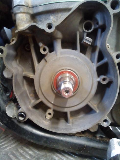

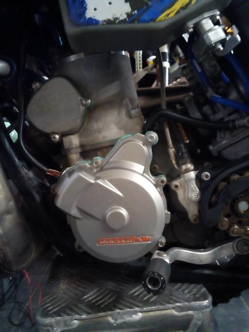

Tak jeden upgrade hotov.
http://www.offmoto.com/uploads/thumbs/4098_7.jpg http://www.offmoto.com/uploads/thumbs/4098_8.jpg http://www.offmoto.com/uploads/thumbs/4098_9.jpg
